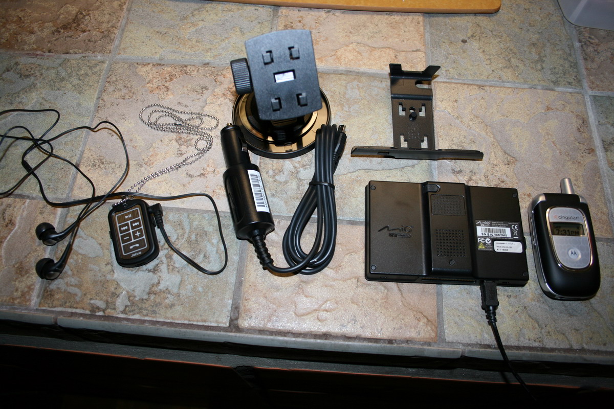

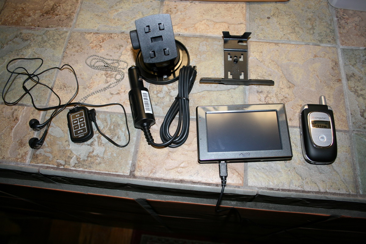

:rockon: !!!!!!!!! Everything got here today....
The bluetooth works flawlessly, and the Jabra receiver will fit perfectly inside the helmet, keeping access to the play/pause etc buttons (using left hand thumb).
The Jabra earphones even fit with my helmet, which I did not expect. Not sure if the max volume will be sufficient using them, so I`ll try my own sony too (which I forgot at work doh)...
The gps is surprisingly light... quality seems great and all the stuff was included.
A great bd present and my wife told me she`ll get me the 16gb SD card too woohooo!
Can`t wait to play with the route tracking/recording feature.

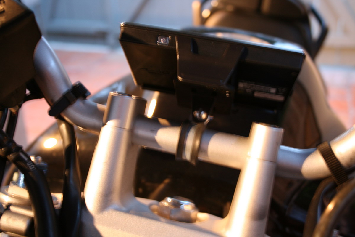

I've got a RAM handlebar mount on order, so I should have all the bits ready for installation on my bike in a few days. I'll post a report here with pics once it's complete.

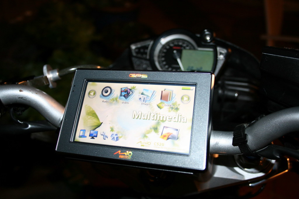

Ok I tested the setup this morning on my way to work and everything worked great. Even the sound was loud enough @ 80mph on the highway. The only little issue I seem to have is that the sound skips for a 1/10 of a second every 2-3 minutes. It's definitely the bluetooth connection skipping, but not sure if it`s the GPS or Jabra receiver... anyway, I really don`t care for my use, but I thought I`d let everyone know.
Yeah the earphones are fine with my helmet, when putting it on and taking it off.... I have a Shoei RF1000, which fits quite tightly on my head.

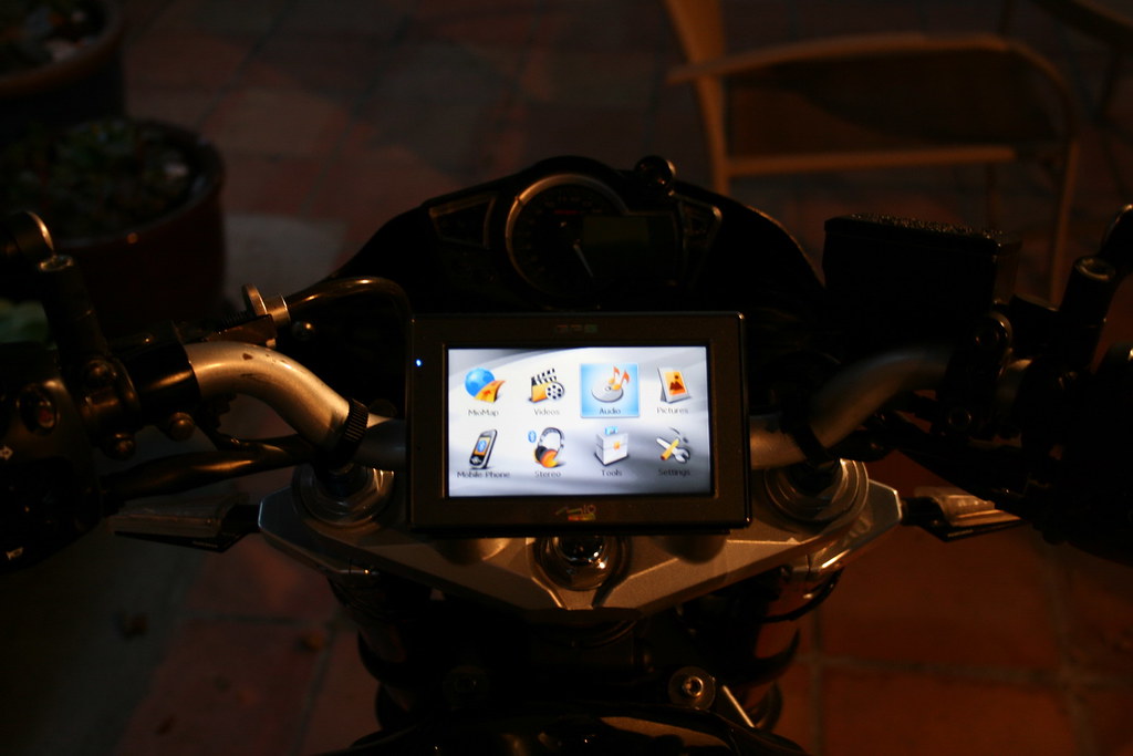

Got power!
Powerlet :: Kits
- Lift the tank up,
- unscrew the battery terminals,
- insert power lugs from the powerlet cables (black '-' and red '+')
- screw terminals back on battery (used ziptie to lift up the square PITA bolts......),
- hide wire between airbox and frame, all the way to underseat compartment,
- plug "cigarette socket power adapter to USB" cable (came with my Mio) into powerlet cigarette socket, & anchor under seat,
- run back wire from power/USB cable back to front of tank,
- drop tank
Power for GPS and my cellphone!
