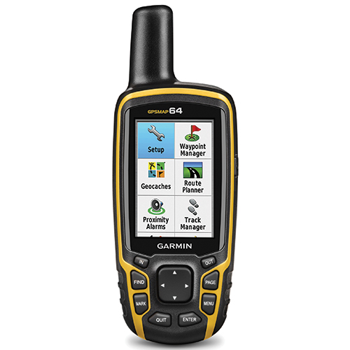

It's been discontinued, I believe, but the Garmin GPSMap 64 seems to be very similar, for about $330.

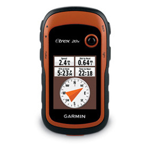

Or you could go even more basic and cheaper with a Garmin eTrex 20x for $250.
