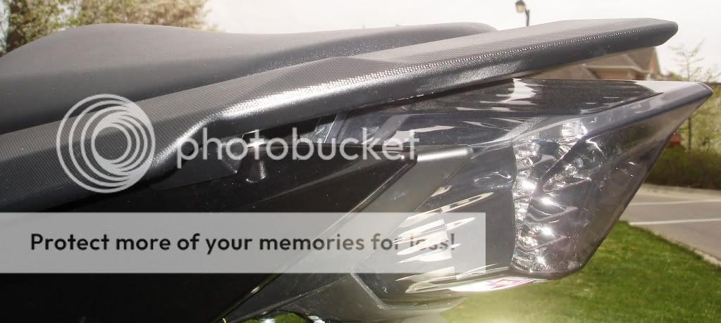

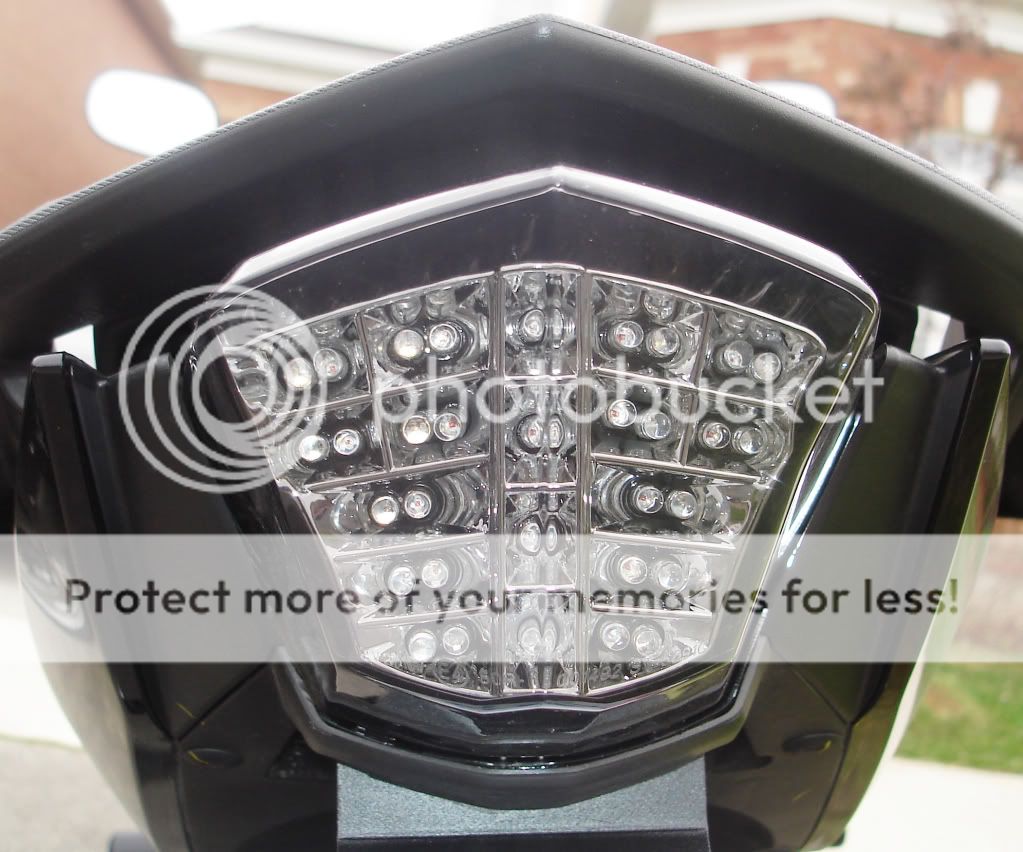

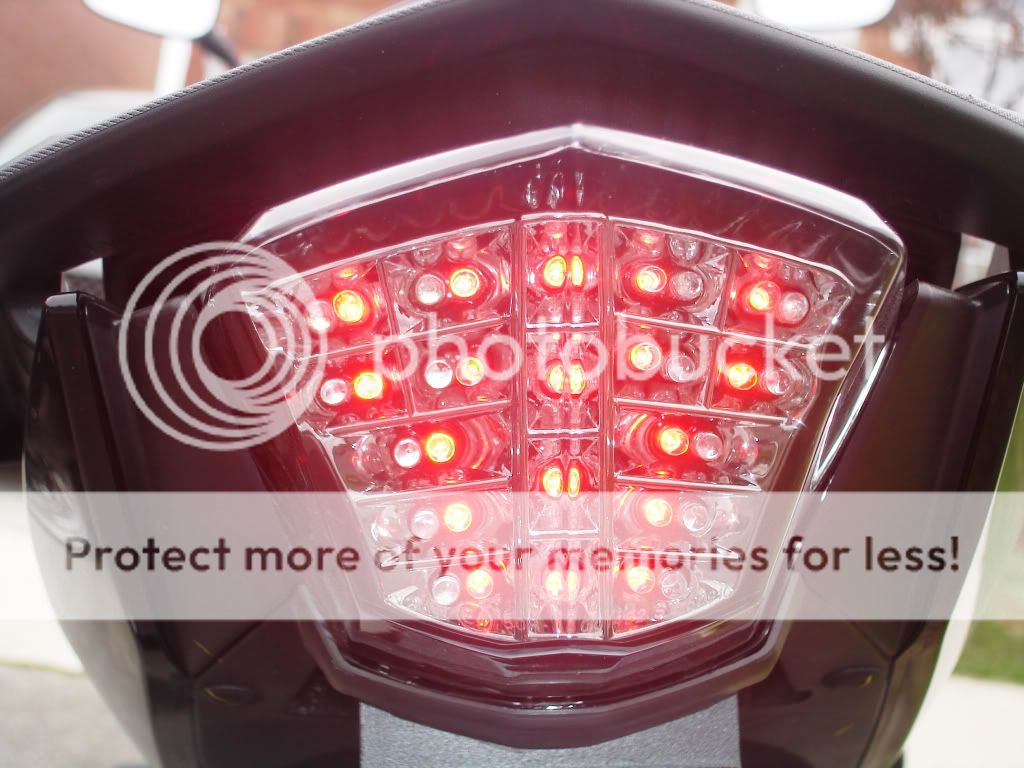

I hooked up my tail light today. I am good with wiring, so the difference in plugs wasn't a problem. I didn't like the integrated blinkers, so I hooked up new smoke turn signals. Anywho, here's a few pics...
