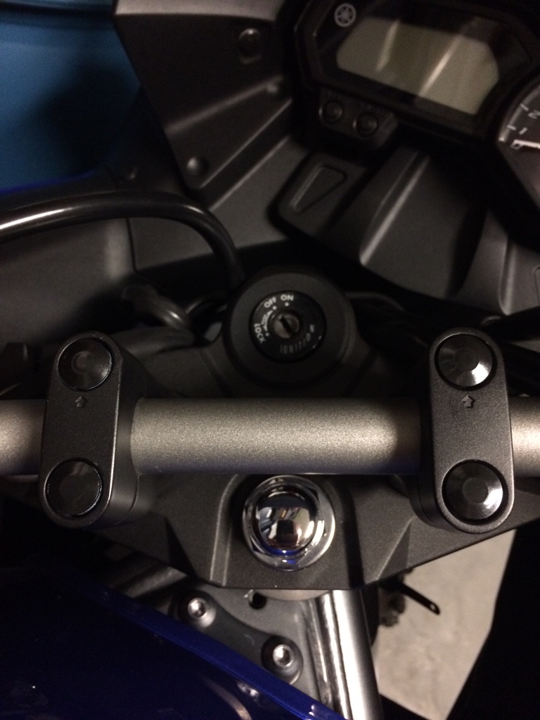

Hello all. I just picked a 'new to me' '13 and would like to try the handle bar adjustment. Can anyone tell me what position this is in now?

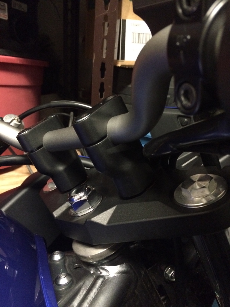

I have rolled the bars towards me a bit and really like the result. But is there more there for me with turning these risers?

It's in the stock position (handlebar closer to you).
Regards!
Thank you AL72. So if I turn the risers it will put the bar closer to the windscreen and offer a sportier riding style? If I rotate the risers, will the arrow on the cap still point towards the front of the bike (as they are currently)?
Yep, just rotate the risers, and install the caps with the arrow pointing to the front (as they are in the photo).

Loosen the bottom nuts first, before you take the 4 top bolts off.
You can turn the risers to move them to either the forward or rearward position. You can also rotate the bars up or down. The control housings can't be rotated. There's a pin in the housing that keys into a hole on handle bars.
