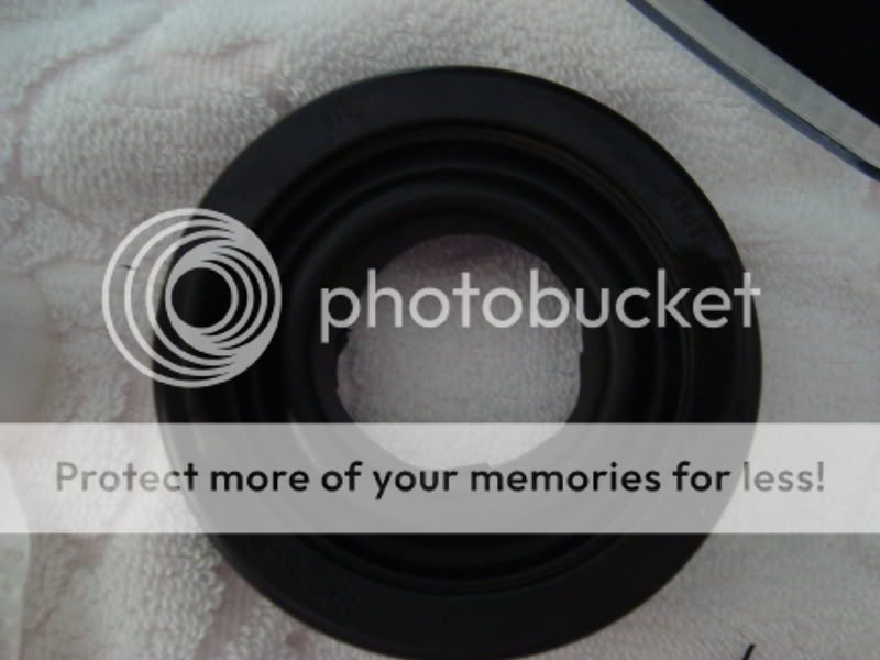

I got everything apart, tested the electronics before assembling everything and it all works great. The only problem I'm having is trying to figure out where/how to cut the rubber boot that goes over the new bulb. With the casing and parts connected to the new bulb there is no way to stretch it over the front ot the back of the HID bulb assembly. Anyone have a pic or able to explain how they cut theirs? I'm not sure how important it is but since it is to keep moisture out of the headlight I really want to do it right the first time.
Skirat
Thanks for the pic, just what I needed!
