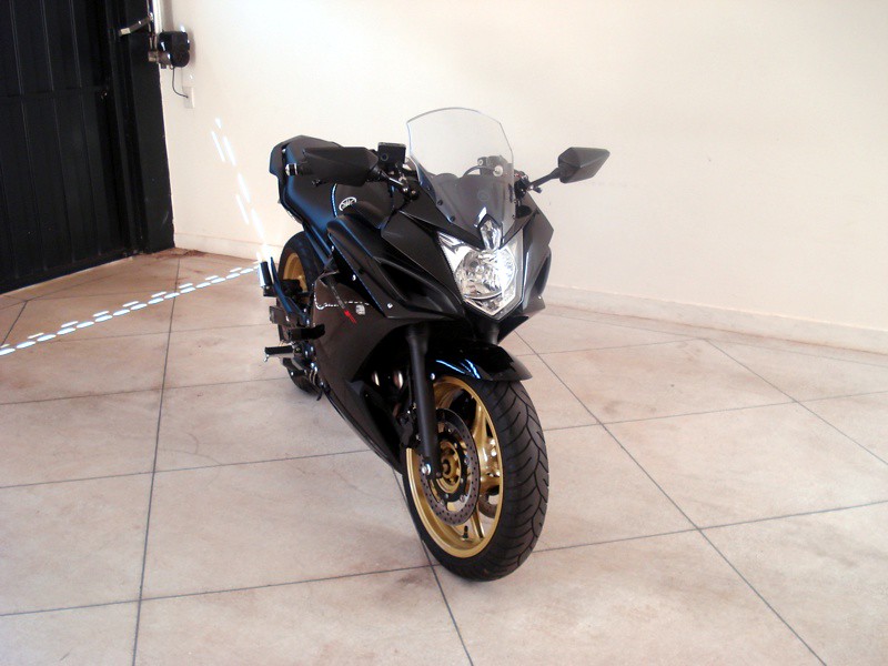

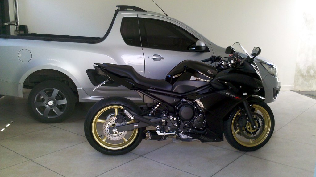

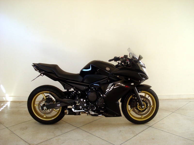

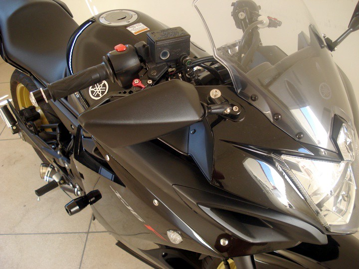

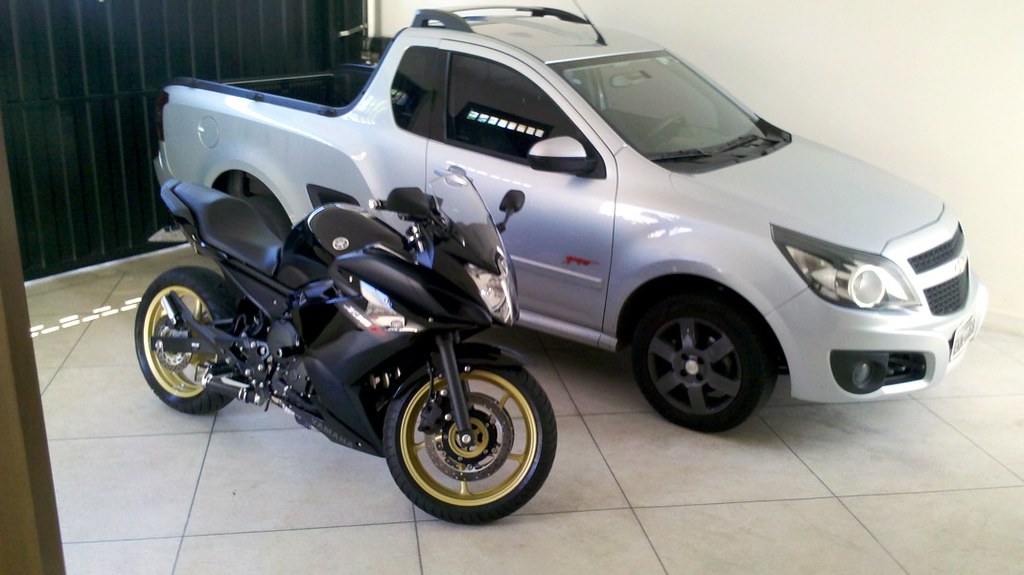

Apex clips + ZX6R mirrors:
picture.php
picture.php
:Sport:
Mirrors that I tested...
Mirrors that I tested and a general evaluation (design, quality and visibility) in a scale of 0-10:
CNC Reversal Bar End Mirrors(ebay) - Rating: 6
picture.php
picture.php
CRG Bar End Mirrors LS Insight - Rating: 9,5 :thumbup:
picture.php
picture.php
ZX-6R 08 Mirrors(ebay) - Rating: 7,5
Top CNC Tomok Mirrors - Rating: 8,5
picture.php
picture.php
Kawasaki Ninja 250R 2012 (Original Parts) - Rating: 10
picture.php
