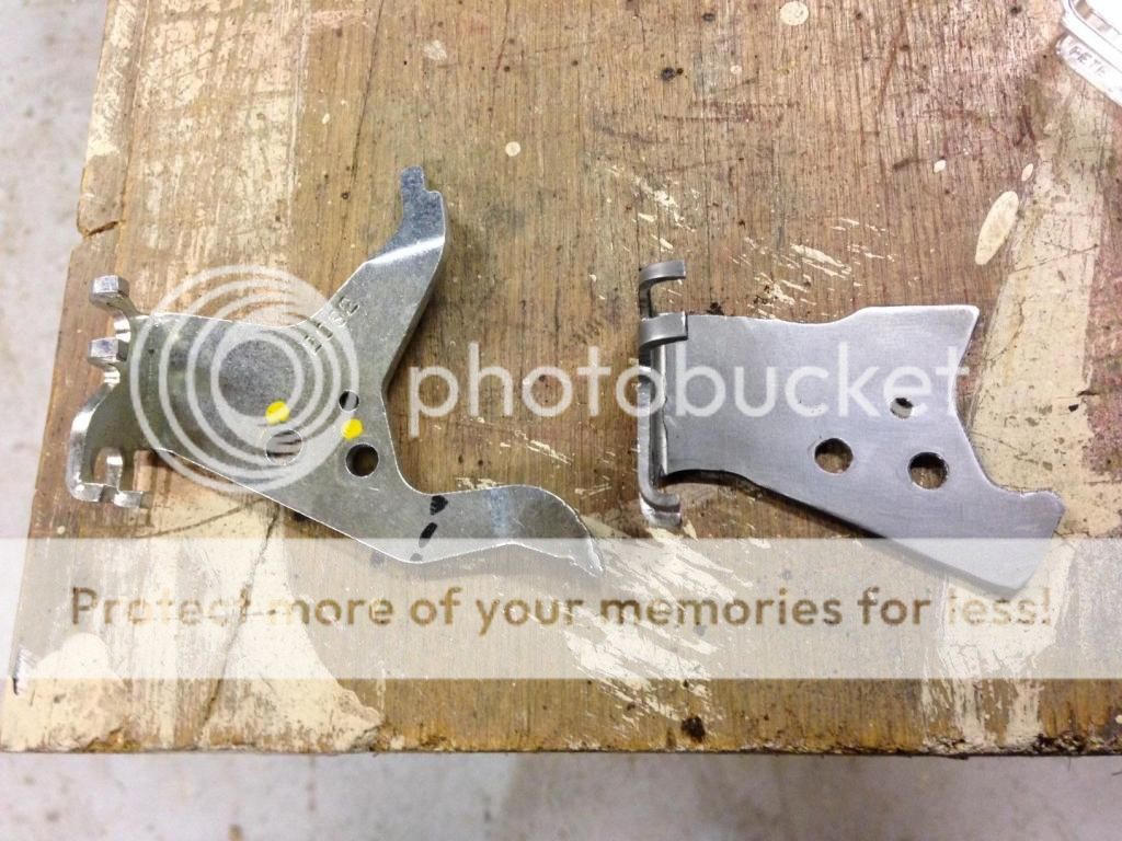

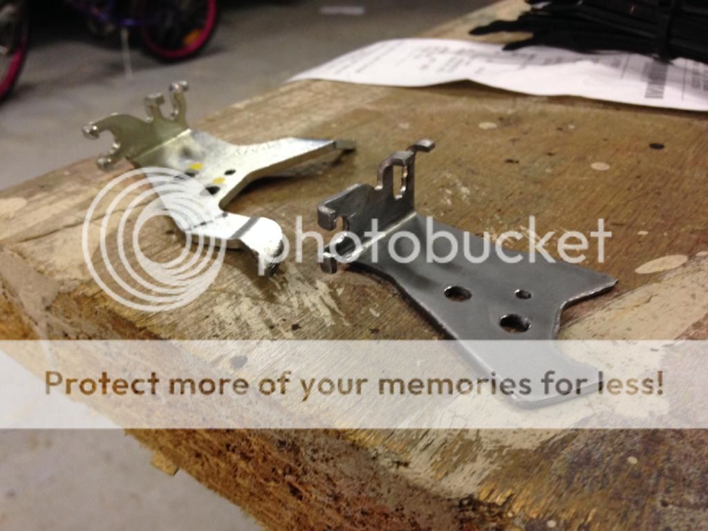

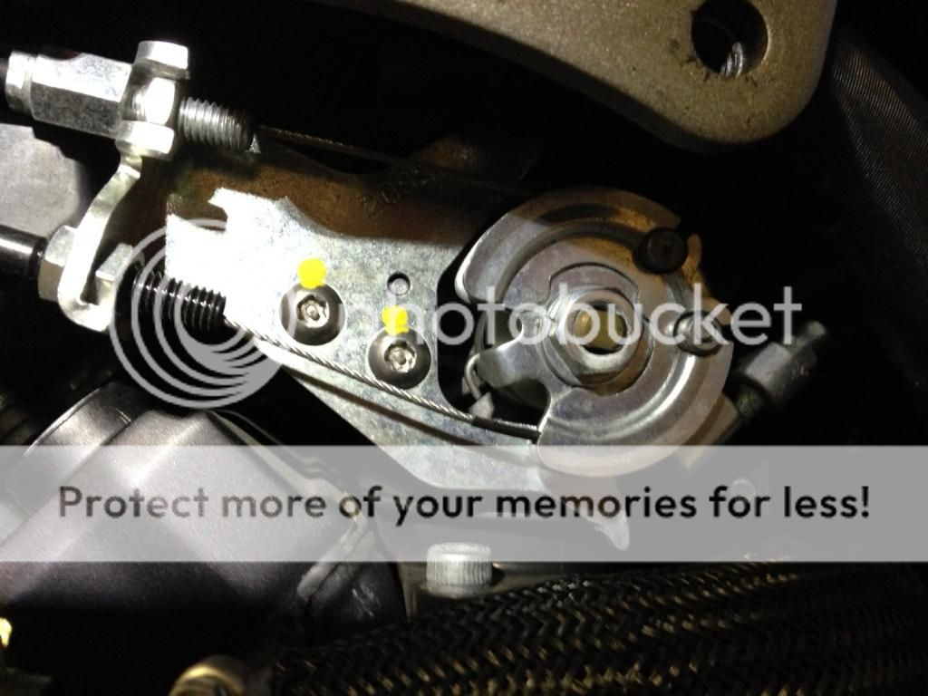

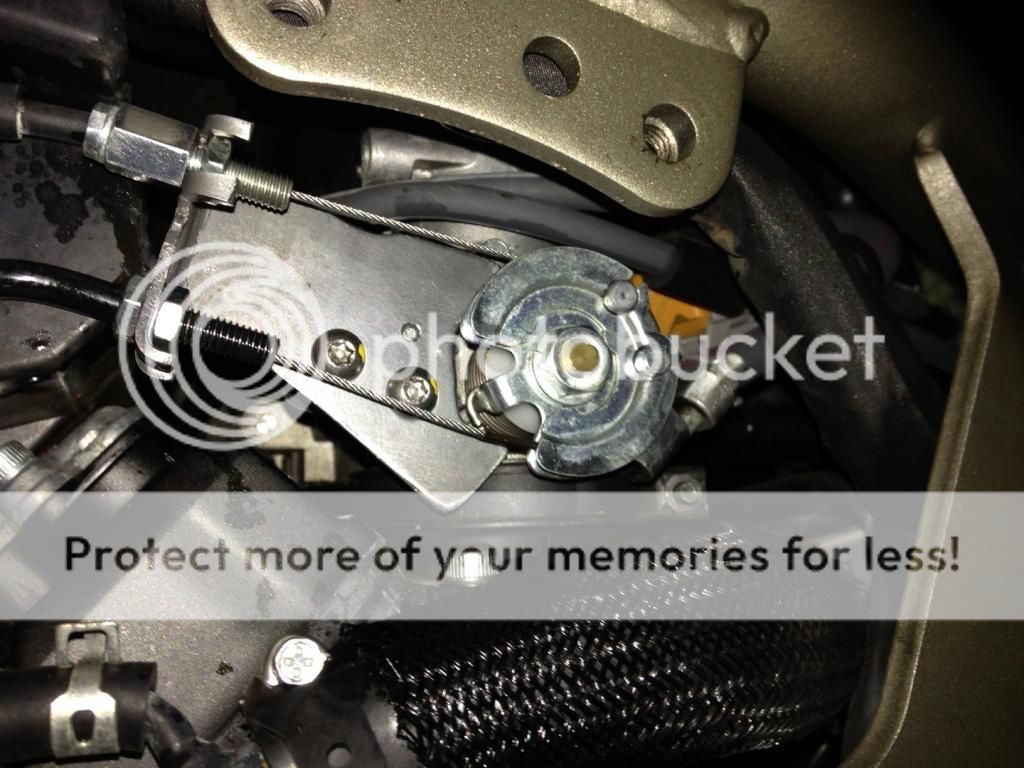

Grizzly
Hi All,
Made my own de-restrictor bracket last night from some scrap stainless steel that I had in the garage. I think it came from a bracket that was supposed to wall mount my dryer in the laundry and had a handy 90 degree bend already fabricated into it. The material is thinner but still plenty strong enough to resist bending when the throttle is applied.
I got a friend to help me monitor the angle of the butterflies as I actuated the throttle so that I could establish the correct 'Wide Open Throttle' stop position.
Took a couple of hours in the garage to cut, grind, drill and bend the bracket into a shape that worked and then to install.
I tested it on the way to work this morning and it works like a charm. Really happy. The pictures are of the old plate sitting beside the new and with both of them installed. It would have been a simple job to modified the existing bracket but I wanted to keep this one just in case I decide to sell the bike later as a LAMS.
Seemed like a bit of a waste to buy one delivered for $165 when I could make one myself.
Now I'd like to convert to a naked. Just need to work out how to convert the headlight mounting so that it's connected to the front forks instead of the frame and purchase some new fairing panels.
Old
Side by side
Installed

Grizzly
Thanks Bert.
My last bike was a L2 GSXR-1000 which was stolen about 3 months back. To be honest it was a little over the top for the commute which was what I was mainly doing on it. I did two track days in the 9 months that I owned it and it was great there though.
I like the FZ6/XJ6 because it's perfect for the commute and it's also going to be brilliant for the odd trip i do each year. I'm really happy with the purchase and it was excellent today now that it's derestricted. Hell, I might even take it to the track!
With the restrictor plate on I was lucky to get 20 degrees of throttle. The only way I could accelerate briskly was by short shifting, there was absolutely nothing above about 6k.
I really like this motor and the suspension is really well suited to the road. With the wide bars i actually feel more confident tipping it into corners on the road than on the gixxer. I'm looking forward to taking it on a trip into the high country in December later this year.
