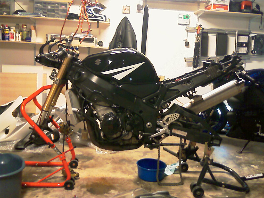

more progress! here is the updated list:
1 chain/sprockets: inspect/clean/adjust: DONE!
2 check battery: DONE!
3 drain fuel from tank DONE!
4 oil + filter change DONE!
5 replace all coolant hoses DONE!
6 replace fuel line DONE!
7 flush cooling system (use water wetter) DONE!
8 change fork oil: DONE!
9 check steering head bearings and re-pack grease: DONE!
10 check/replace air filter DONE!
11 fix handlebar end (right side is loose): DONE!
12 replace spark plugs: DONE!
13 re-build front brake
14 check valves and adjust: DONE!
15 find and fix the electrical turn signal issue DONE!
16 check/adjust engine idle speed
17 check/adjust clutch cable: DONE!
18 check/torque main bolts
19 lub control levers + brake pedal, gear shift and side stand pivots
20 install track plastics
Almost there!
In order to to flush the water system (did it 3 times) and change the oil and filter, I had to be able to run the engine, so I put the airbox back on, along with the gas tank and battery... I did not know if the bike would run without the speedo, but I was glad to find out it works.
With all the maintenance, the bike runs SMOOTH! Start up smooth too. :rockon:
Getting the tires swapped early next week (putting pilot powers from Buell on Gixxer).
Hopefully I can get the track plastic on the bike somehow tomorrow (Still need to find an online instruction manual for that) :D

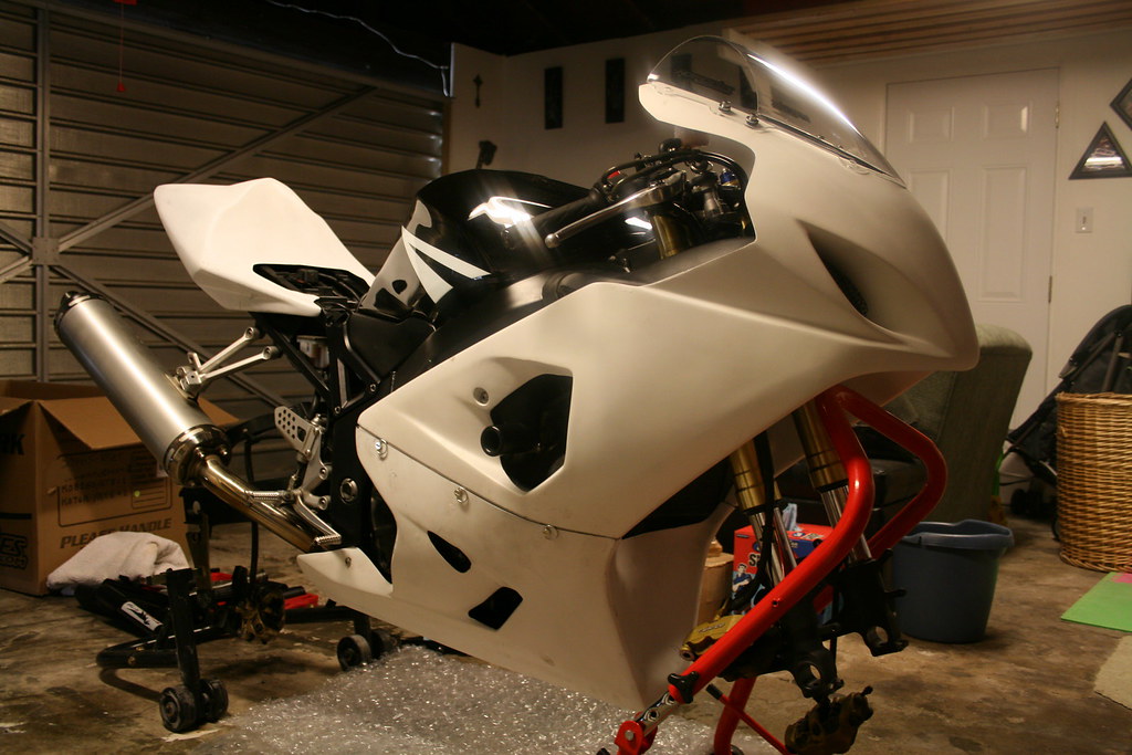

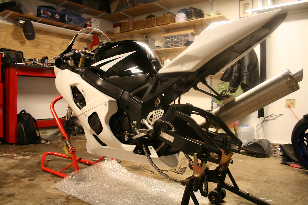

and it's coming along... I just finished the plastics, except for securing the rear section, which is easy... The side and lower plastics were quite a bitch to match up, and the fit is loose (had to be very patient), and some parts are not lined up perfectly, but I don't care it looks good enough! I actually expected worse considering what I had read online about the hotbodies...
So now I just need to build up a couple of custom mounting brackets for the speedo, rebuild the front master cylinder, put knew brake pads and seals in the front calipers and install the Galfer lines in the front... Hopefully John will be able to spend an evening here to help me with all that :rockon:
After that I will take care of the tire situation on Monday/Tuesday and the bike should be operational for D-Day!!!
