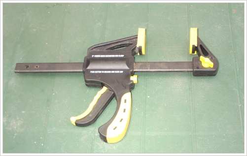

yeah, the rubber strap that goes into a handle and then uses leverage to keep itself tight as you turn. If you have the room it works pretty well, but is completely useless in tight spaces
and if you have enough room to use one, then you could always use one of those quick ratcheting type of clamps:
