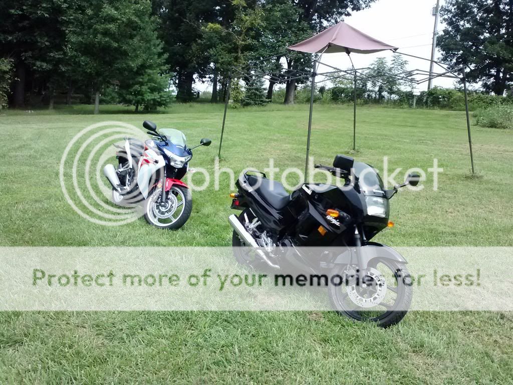

Ha! I haven't been able to bring myself to sell mine either. 06 red w/red flames.
Here's mine only it now has dual TB exhaust on it. I gave it to my wife but she will not get on it ? It was even lowered for her. Its pictured with the 2013 CBR250R I had.
