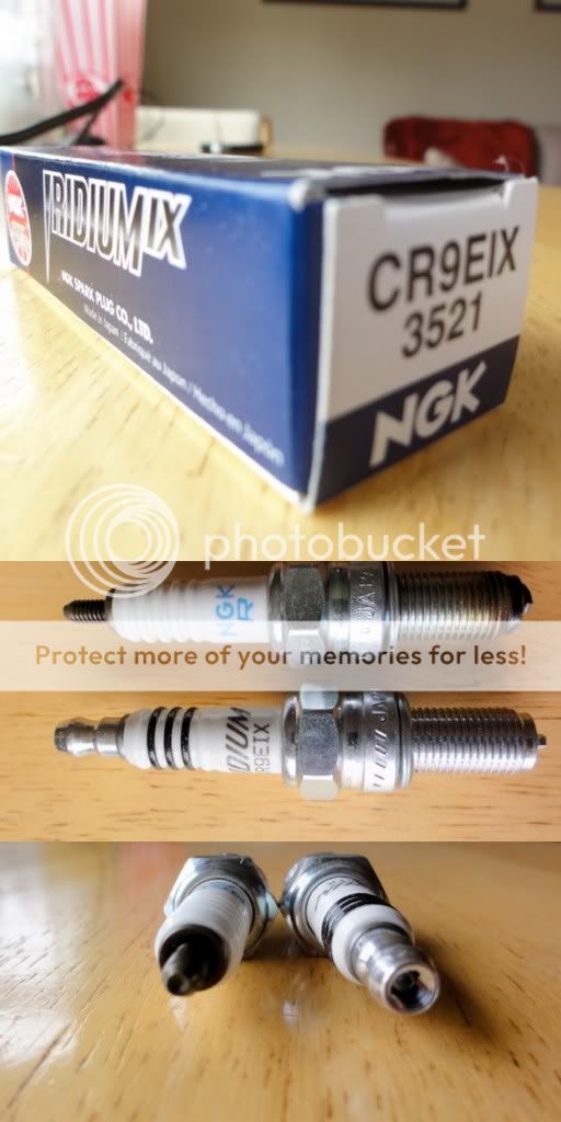

Here's a how-to write up on changing out your spark plugs. I replaced the stock plugs with NGK CR9EIX Iridium spark plugs. It took me just over two hours to do the change out from start to test ride, but I took my time and could do it in less than an hour next time, knowing what I know now. It's a pretty easy job IF you are mechanically inclined. (My disclamer - If changing the oil is intimidating to you, don't try this at home)

STEP 6: Remove one spark plug wire cover one at a time. (pic 7) They just pull off with a little upward force. Once they pop off, they are quite long. (pic 8) Then use the long spark plug tool from the tool kit and remove the spark plug. (Pic 9) Before you replace with the new spark plug, I suggest putting on some anti-seize lubricant on the threads. Put in new plugs and replace wires.

I do feel that these Iridium plugs made the bike seem to run smoother with less vibration. Plus, they should last longer than stock, hence not have to replace them as soon. Hope this write up helps.
(Pic 10 - Stock plug with over 13k miles on it)

Thanks. All four of the stock plugs looked good like that. Didn't really need to change them, but I'm happy I did. Now with 500+ miles on the new ones, it still runs smoother.

I have the spark plugs out and see that the ends are different from the ends of the new ones. I'm not sure what to do now.
