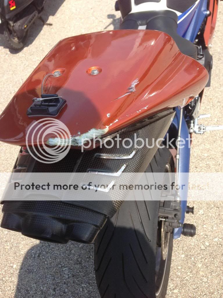

It's cracked going down the side a few inches, and of course, the hole in the back. His clip on and lever is what got me there. I didn't even know he hit the bike at first, I just felt his front tire hit me in the leg. His response, "I thought you seen me." :facepalm:

But yeah, that is going to be a pain in the butt to fix. you will need to do wide V cut into the crack and then the corner is just going to be an utter pain in the butt to fill.
Basically for both you will take normal fiber glass sheets and pull the strands out and cut them into about 1/2 inch fibers, mix with resin and start filling in. The key will be to force the fibers in with resin but trying to keep the amount of resin to the point that it only fills the gaps between the glass fibers. Also along that crack you will want to cut essentially stitch line so that you can fill those with resin and mash fibers into them so it will help build the strength back. Another approach is to just cut a path along that section that is cracked about 1/2 inch wide so that you can just lay sheets of glass in there that are 1/2 inch wide. That would be strongest fix so that it doesn't crack again.
The whole in the back is just going to need basically an over fill and then sand it down by hand until it matches the other side. when you are using heavier sand paper and you think you might be getting close then it's time to switch to say a 600 grit, from something like a 280. That way you wont take out too much material. Just keep in mind it's always easier to take tiny amounts off than put more back in. I would finish it with about 800 before you paint. 1000 would give you too much of a polish and would make it harder to get paint to stick. 600 IMO is a little too rough for a primer surface.

That seems like alot of work, for an "inexpensive" piece. A new one is around $200 plus painting; or just pay $300 for a CF piece. :rolleyes: I'll ride it as is for the last weekend of the year, this month, and go from there.
