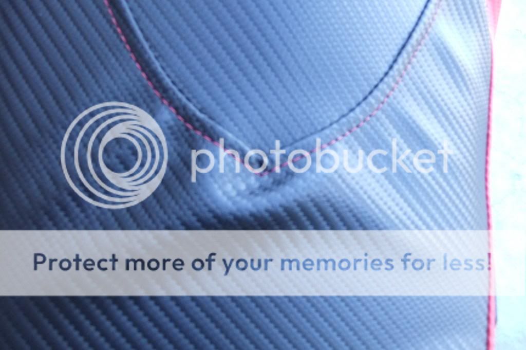

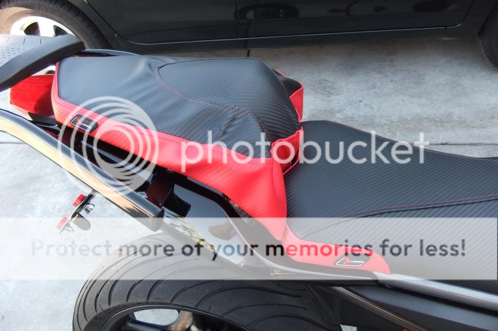

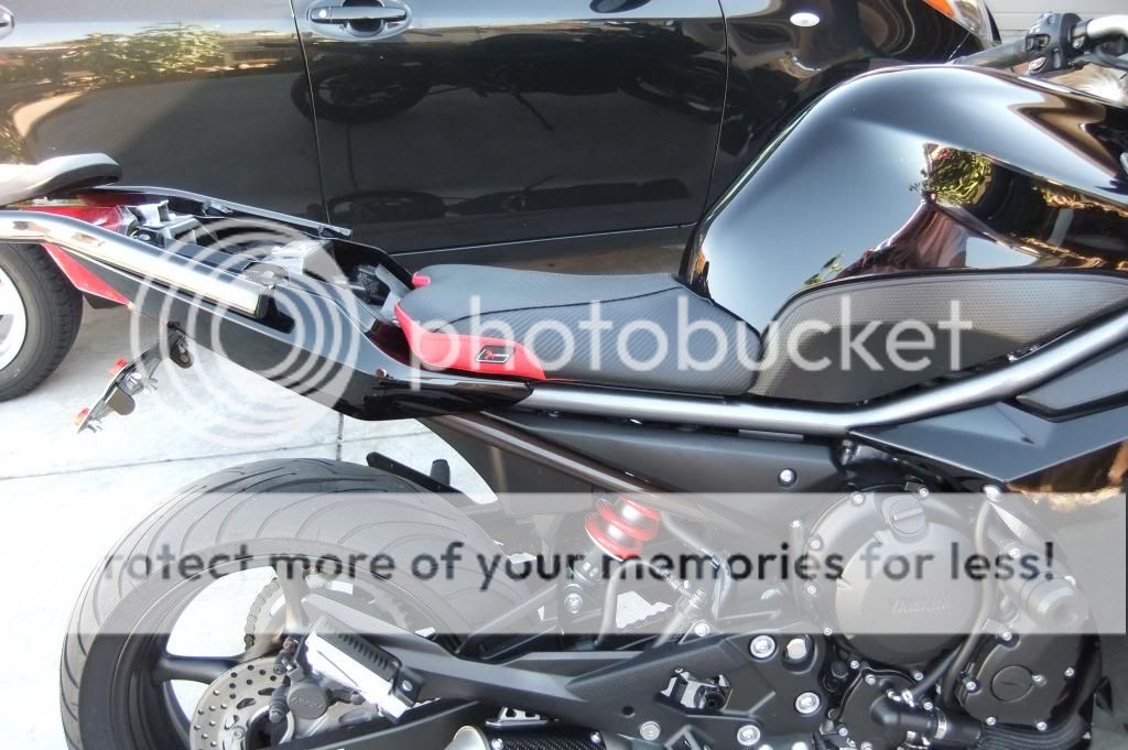

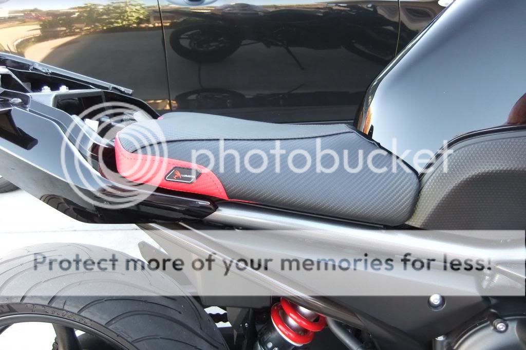

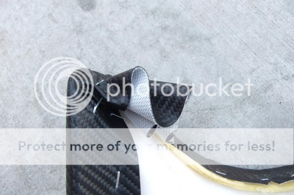

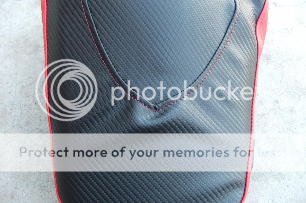

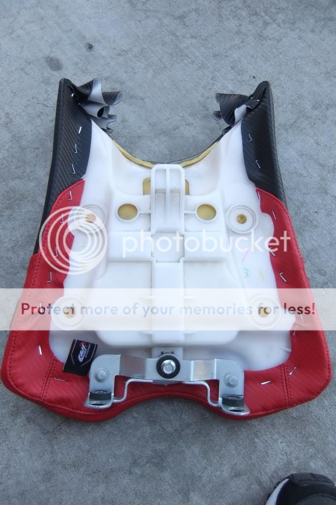

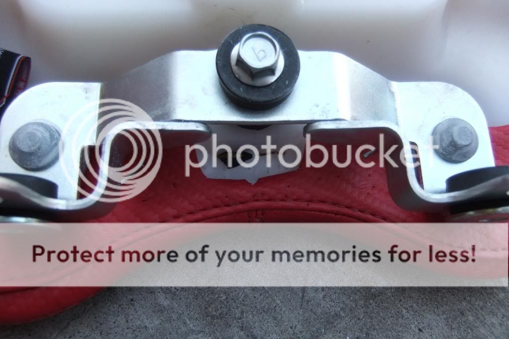

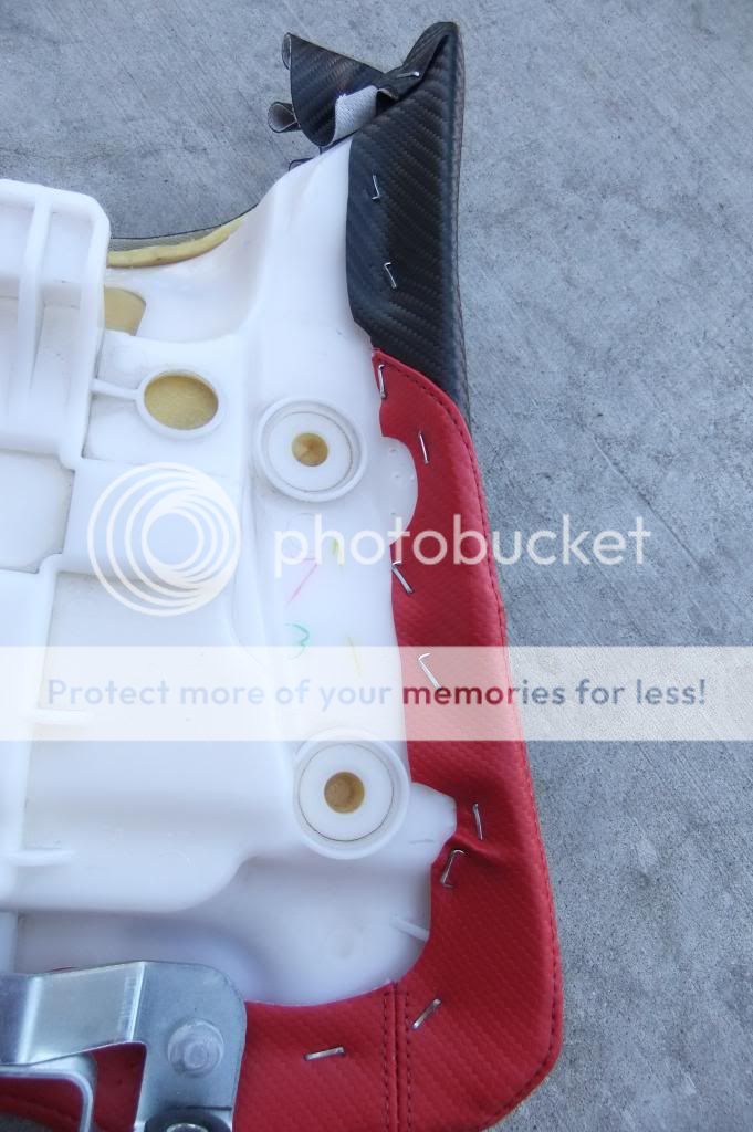

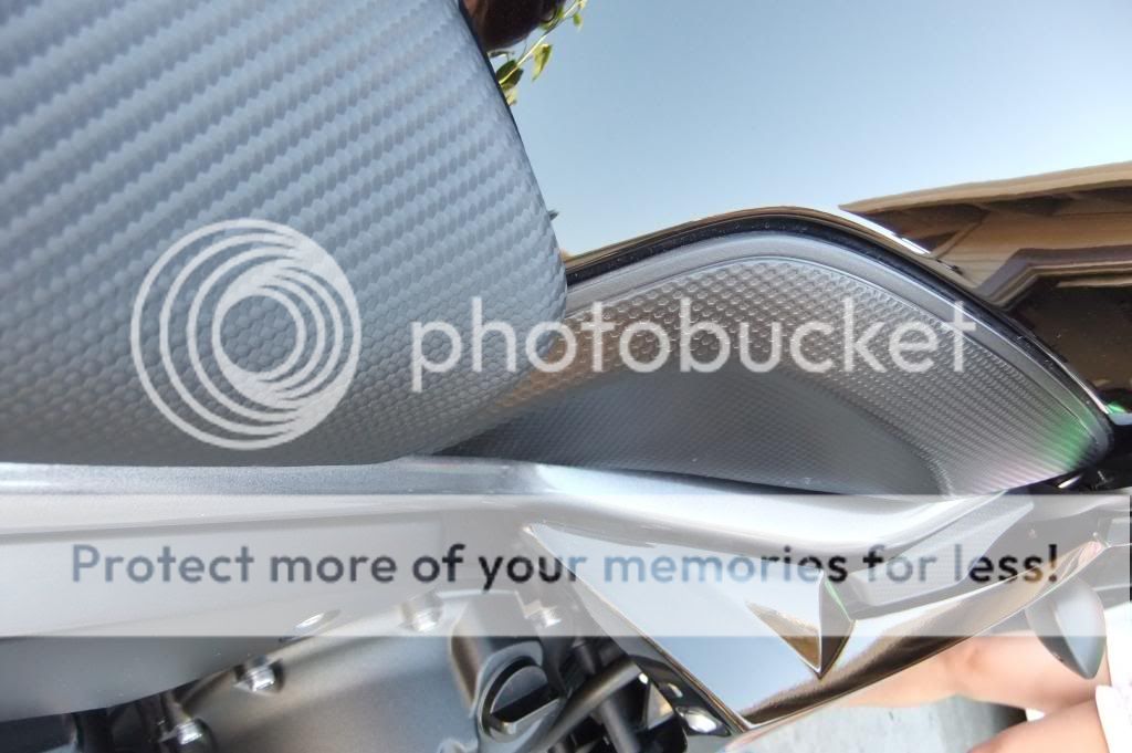

Ok, here are a few picts of the front and the frustrating rear. It is a tad bit firmer that stock, the fabric has less stretch than the OEM stuff. That's why on the underside you can see that I only put like 1/3 of the staples that I took off, not sure if it's going to stretch and I have to go back and add some or stretch it more so I will drive it for a few hundred miles then finish up stapling it.
You can see that by the bracket on the underside I didn't put staples there, I did that on purpose as when I put staples there it created a wrinkle. I really don't see a problem not putting any there and as you can see from the top it looks fine.
The color itself I chose was close to stock, you can never get and exact match with OEM unless you buy OEM. Also, the carbon fiber fabric goes will with the carbon fiber pieces on the tank and other places, also goes with my CF slip on.

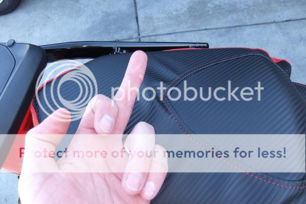

The wrinkle I am dealing with is next to my finger :) No matter how I do it I can't seem to get it out so I am going to try a bit more tonight and if I can't get it I will be dropping it off at shop tomorrow and will pay them extra to finish it up by tomorrow night. If they can do it I should be ready to roll by tomorrow night.
