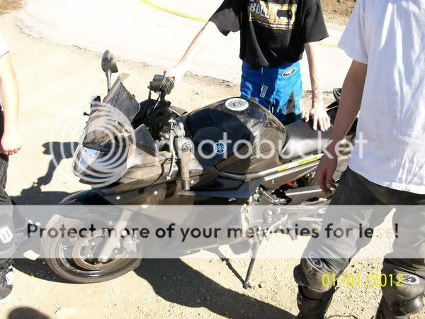

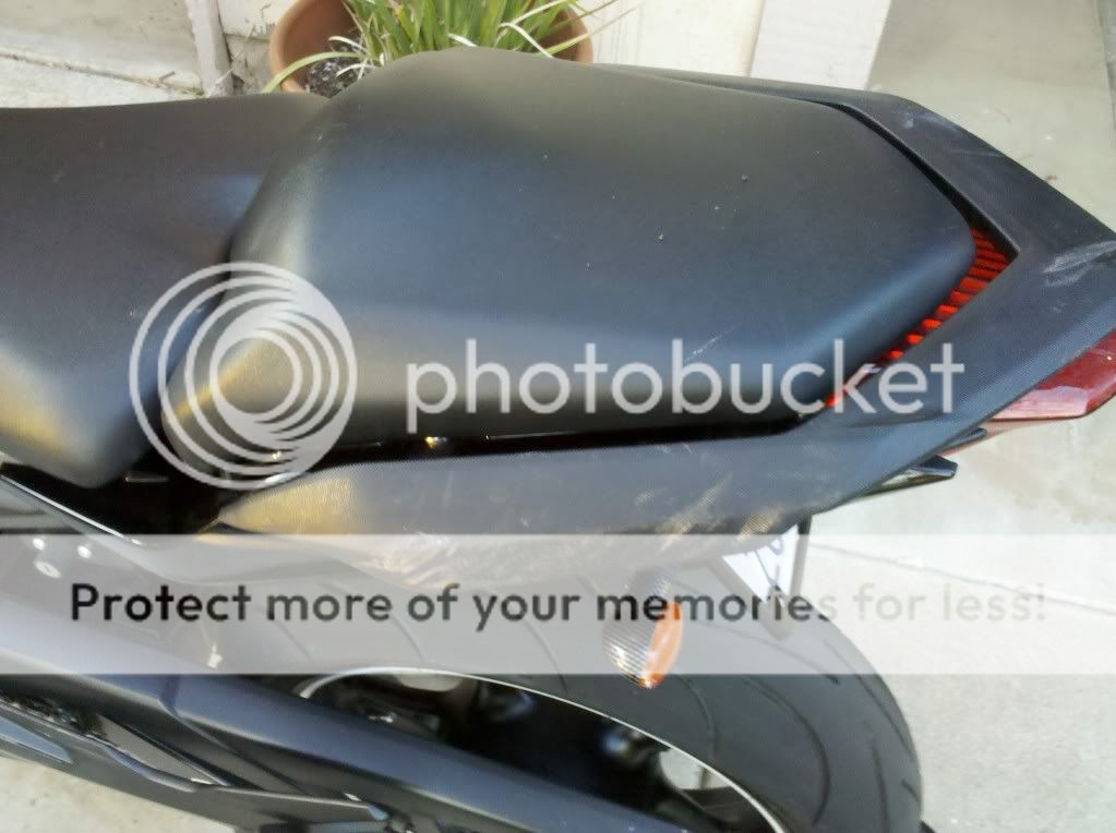

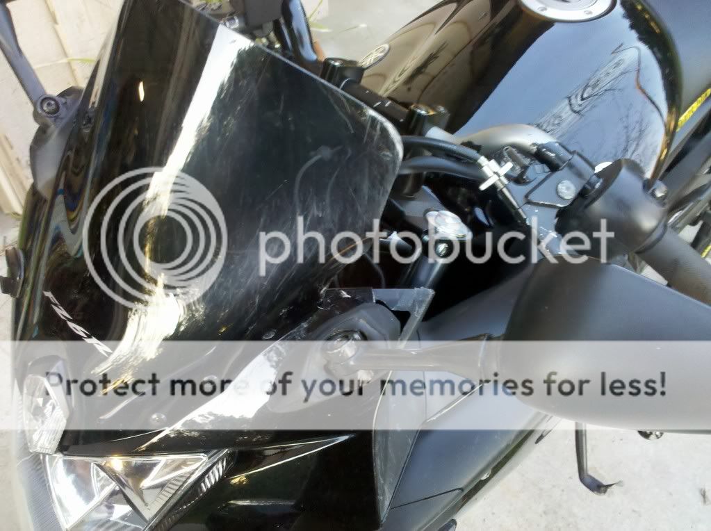

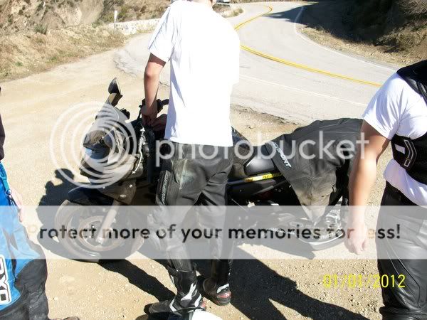

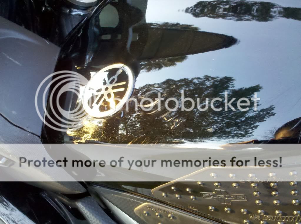

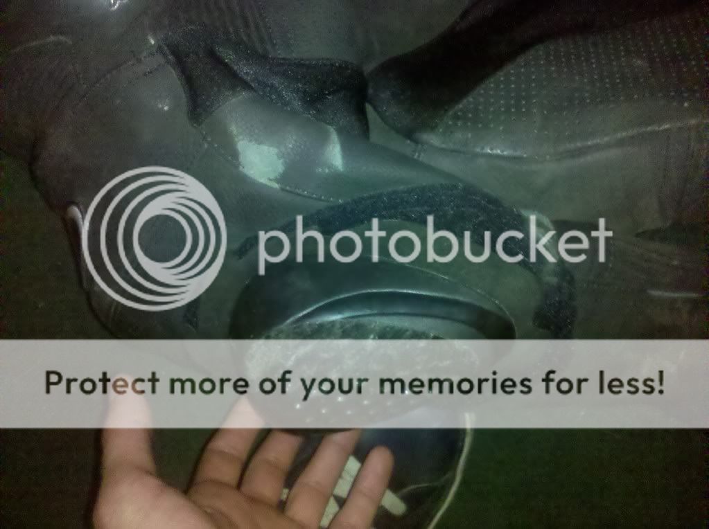

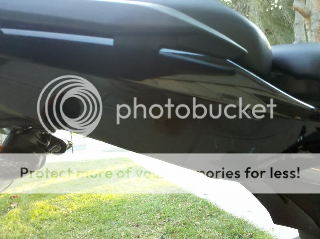

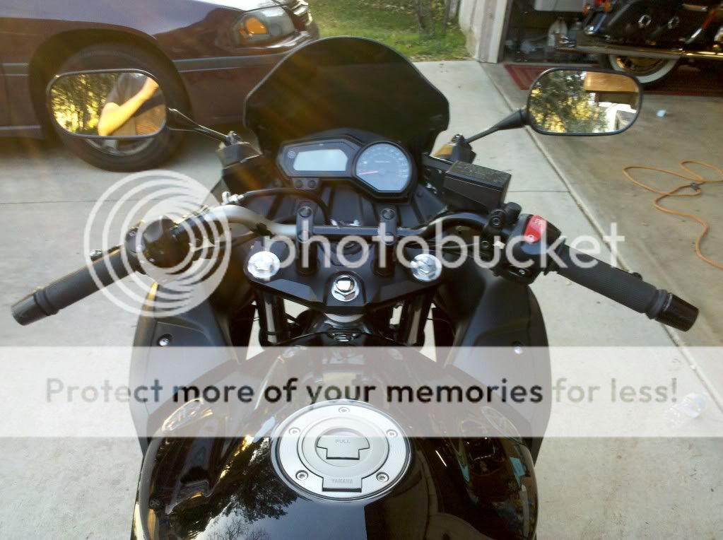

Anywaysss here are the pictures i promised
These are right after the crash

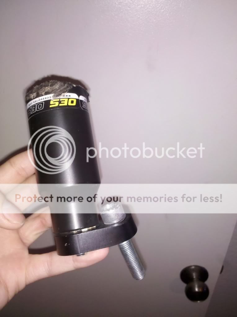

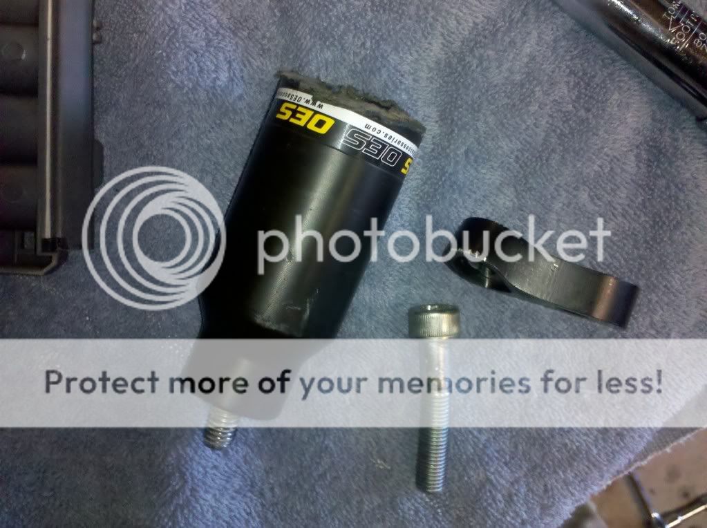

And here's a pic of the frame sliders that saved a lot of my bike and probably my leg from getting slammed on by the bike

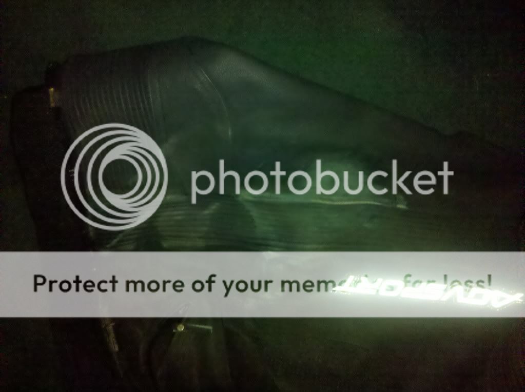

the gear that saved me from pulling rocks out of my skin
atleast i got my knee down good :rolleyes:
and here she is all nice and cleaned up

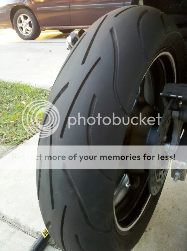

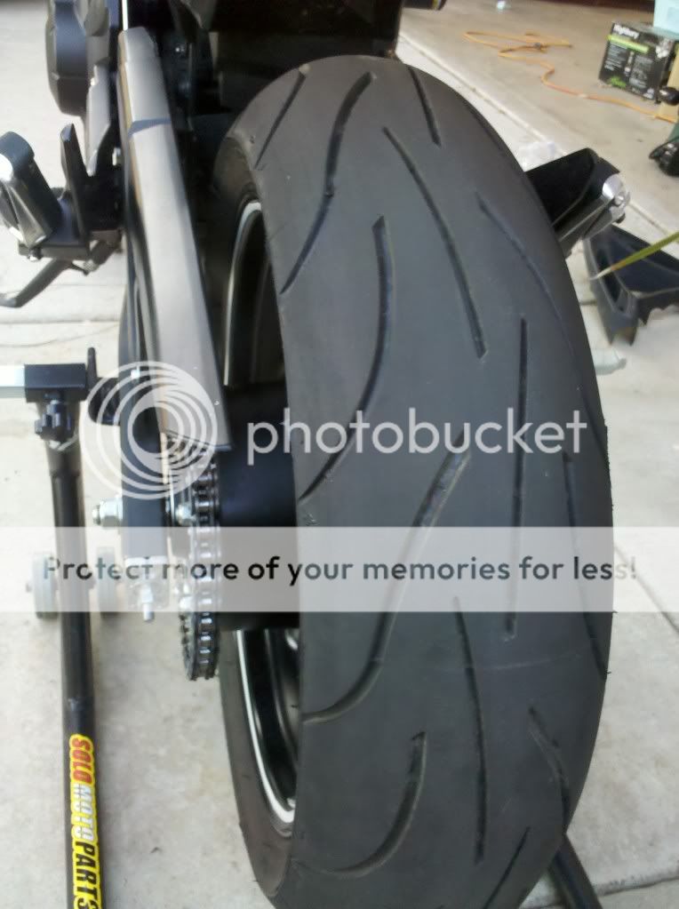

here are the tires were my dumb ass didn't break in enough to be riding like i was
