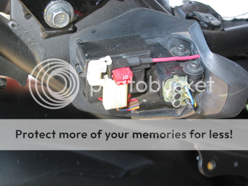

This piggy back power tap is an effective way to get switched power without hacking up the bikes harness. It's cheap and fused using the same atm fuse type on the bike now.
It's running my fuel controller and data logger...
Bussman #BP/HHH-RP
And if you have to tap, use a Posi-Tap... they do the least amount of damage!!!
