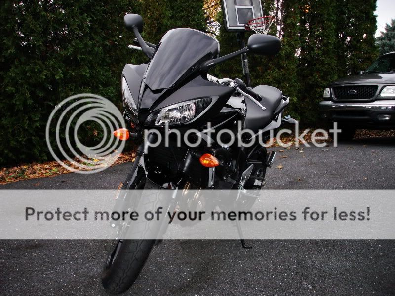

well i broke down and painted it while i installed some purple neons to give it a nice glow throughout. some other stuff done too, im going to try to get some pix up when im all done prob in 2 weeks
jersy19
finally done :) im happy with it, im going to put a custom yamaha symbol on the bottom of the windscreen next in silver when i find the right design

goat (or anyone else who painted)....did you paint the inside of the windscreen? How did you prep for it scotchbrite pad? Looks awesome!
More pic's if you can please.
Yes, if you paint, you want to paint the inside. This way rocks and debris won't chip and scratch the paint on the windscreen.

<Replied a bit late, LoL> Really looks nice - GR8 job :thumbup:
DO NOT, I repeat DO NOT scotchbrite the inside of the screen. BAD things will happen. Just clean them with some rubbing alcohol and a lint-free rag, the do multiple LIGHT coats of paint.
jersy19
i just cleaned the inside with some windex and a microfiber cloth and the put 4 or 5 coats of krylon gloss black, about 30 min to an hours between coats and one overnight wait then final coat. used masking tape around edges, forgot to cover the whole front and got some overspray on it but nothing goo gone and microfiber cloth couldnt fix real quick, then windexed the front and put some plastix plastic cleaner/polish stuff . i love it, just trying to find the perfect yamaha design to put on the bottom of it so its not too plain
