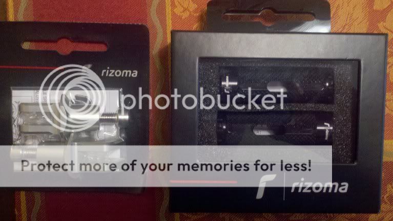

Looky what came today in the mail and is on the bike...next will be the passenger pegs

Rizoma PE614 Tapered Rider/Passenger Pegs wt Adapters, PJ's Parts
When you place the order use the xj6 adapter...total was 86 i believe...the passenger pegs will be next
and the install was super easy and no, NO modifications were required...remove coder pins, remove the main pin, remove the peg/spring, place spring in new peg, line up the holes, replace the main pin and coder pins, DONE

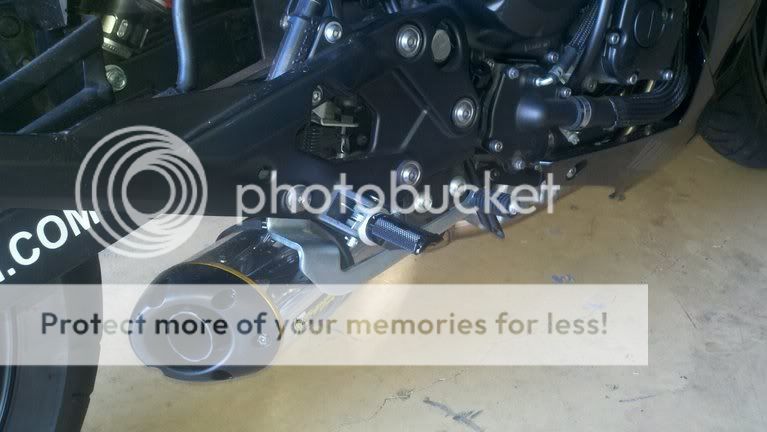

just got in the passenger pegs...whoopy:iconbeer:
cavcuz05
Got them on the bike...im so happy not to have the GAY rubber ones anymore...bike really looks like a SS now:D

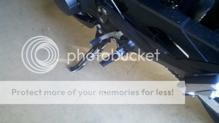

those look good man, have you installed the passenger pegs? I wanna replace those but didn't know if there would be install issues because they fold up.
cavcuz05
Nope everything when on as they came off...out the door it was $170 FYI
