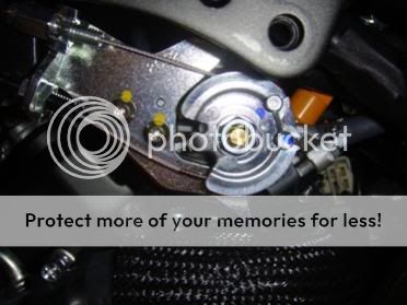

Just wondering if anyone with an XJ6 could post up a photo of their throttle body?

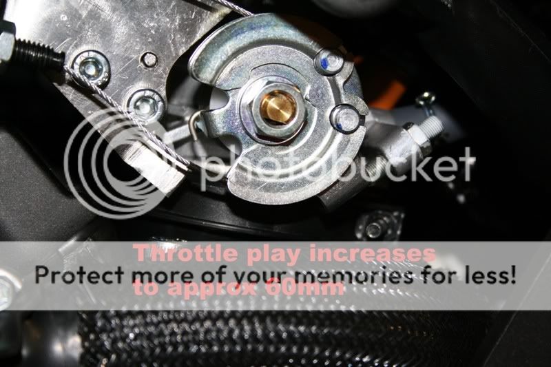

The reason I ask is I have an FZ6R. In Australia they have limited the throttle movement on this bike to fit into learner rider regulations. What I want to do is de-restrict my bike.
Below is a pic of my throttle body. You will see a triangle protruding at the bottom which stops the throttle from opening all the way. This plate would require serious modifications/fabrication work. I was hoping to be able to restore the bike to original condition for resale or should I ever be forced to by the man.
What I am thinking is I could possible buy this part from the XJ6 and fit it as it is essentially the same bike. XJ6's are still very new in Australia and I don't have access to look at one in person.

I just looked at it an drealised it wasn't worth trying. I cast aluminium for a living so now at that thickness, it isn't moving. Thinking about trying to bend the tab on the throttle body itself. This might be easier.

Yeah, I can certainly remove it easily. But what I am after is an easy method of getting it back to this state for re-sale.

I am new to bikes and assume the process for cars applies.... In Australia to transfer ownership of a vehicle you also need a Road Worthy Certificate. Any modifications to a Learner Approved Motorbike Scheme (LAMS) bike is forbidden, especially ones that increase power/acceleration.
Should a police officer discover this modification (extremely unlikely) or a Department of Transport officer find it (high chance of discovery, very little chance to actually be in this position though) the bike would be deemed un-roadworthy and I would not be allowed to ride it until rectified, plus fines.
So while I am more than happy to modify the bike and run the risks as they are minimal. I want to be able to return it to stock condition should I need to or when I trade/sell it.
So modifying the bracket or the stopper on the throotle body is easy to do, neither really allows to easily revert back to stock condition. This is why I would like to buy a bracket for the throttle body from an XJ6 which I can source locally, or one from a US spec FZ6R which I would need to import.

I could buy something and modify it, or I could just buy the one that doesn't require any modifications.... ie one from XJ6. I would like to see a pic of one first before initiating this process.

DcBear78, I'll make a photo today, after the work. Alp, I'm gonna be at dealer tomorrow, I can ask for a part number, if you need one..

Been at the service today, no luck with the photo, as I was told, you need to remove tank cover to get to the throttle body. I'll be at Russian Fazer Club this Friday, those guys will help me out with the photo. Sorry for delay, DcBear78

Thanks mate. Thought being the naked version of this bike the throttle body would be nice and easy to get a look at. Whenever you can, that would be great.

Got the news yesterday and have ordered xj6 throttle body. it fits and is all it is.
$140 and about 1 hr labour. will confirm 100% by monday next week but have seen both throttle bodys (photo) and 99% certain it will work.

No, it's the bracket thing with the triangular stopper that is the issue. Putting on just a different crank isn't going to solve the problem when it stops in the same place.

Also.... Appologies for stealing your pic (from netrider) in the OP.

No news from jeza81, but I can now say...... WAHOOOOOO!!!!!
De-restricted, this bike is a millions times better. Cost me $165 but was money well spent!!
I no longer striuggle to overtake cars. Doing 160 odd by the time I am around a car now. YAY!!!

Pretty much. Just a replacement part so I still got the original if I need it. I got it put on while the bike was in for it's first service. It would be easy to do though. Just robe fairings, then it is just a couple of bolts to undo the original and replace with the new piece.
Give Dominic at Gladstone Motorcycles a call. He fixed it up for me.
