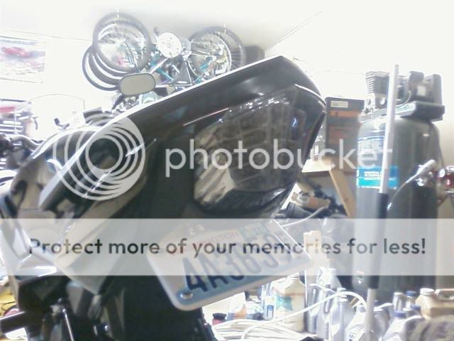

Well its been done, the integrated XJ6 tail light had been fitted onto the FZ6R, the tail light is exactly the same, the wiring IS NOT! Its not a hard fix, you need to either cut up the stock wiring (which I hate doing or know how to solder) I didn't take any pics during the install, I wish I did but I will post a text write up in the morning..
Here is a teaser shot, it looks BAD ASS!! I took it for a ride around the block and had the lady follow me in the car, she told me it is brighter and more noticeable that the original tail light (just looked it parked, it looks dimmer but I am gonna take her word for it)

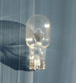

The FZ6R taillight is a bulb almost like this.. (this one sown is only a single filament, the FZ6R has a dual filament which will be explained later)
And the XJ6 is something like this one:
So something has to happen, the easy way, just off the connector on the tail light and cut off the connector on the bike and just attach the wires together. There are (3) wires coming out of the tail light and (3) wires on the bike, just match them up until the light works correctly. All I remember is black on both of them is ground.

just to be clear, this light both brake, and running are brighter than stock because the LEDs are pointed directly at the person behind you, my fiance was behind me and said it for herself. She has driven behind me many times so I would trust her.. She also said that my blinkers sucked!! Now I am talking about the mini blinkers that came with my CW FE kit, she said they were so small they blended in with the brake light and license plate light, stange but ok.. She said this integrated one stands out alot better because its all in the same area, and at night on a black bike the tail light is the first thing you notice so if it starts flashing then you know something is up..

HERES MINE
I used LED's from Cycle Gear that have double stick tape and wired them into the stock wiring and I fabricated a license plate mount and there it is
Notice the LEDs on either side of the brake light they are very inconspicuious
