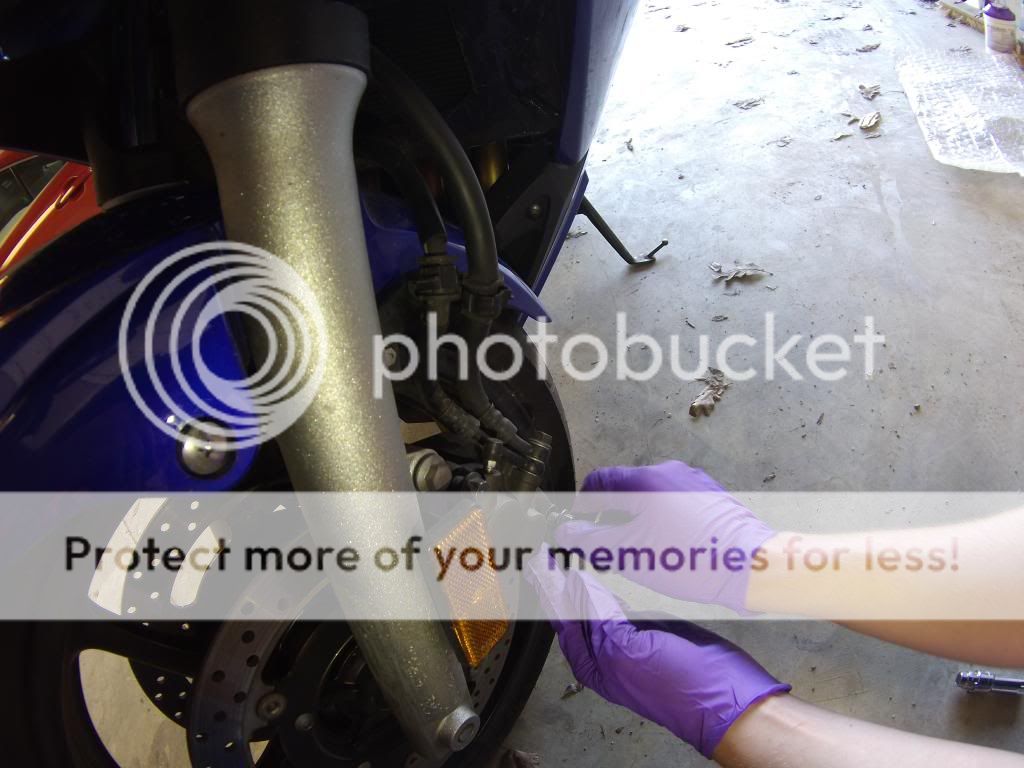

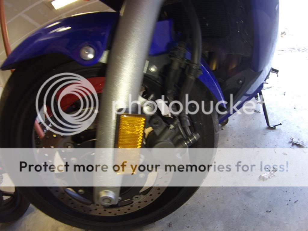

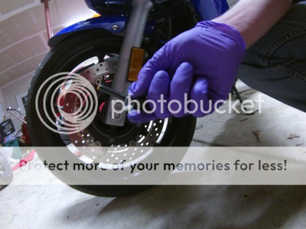

Step 1:
Loosen Both bolts to brake caliper evenly. Do not do one bolt at a time.
Step 2:
Place bolts on clean surface. Be sure not to rub off the lubricant that is on the flat part of the bolt.
Step 3:

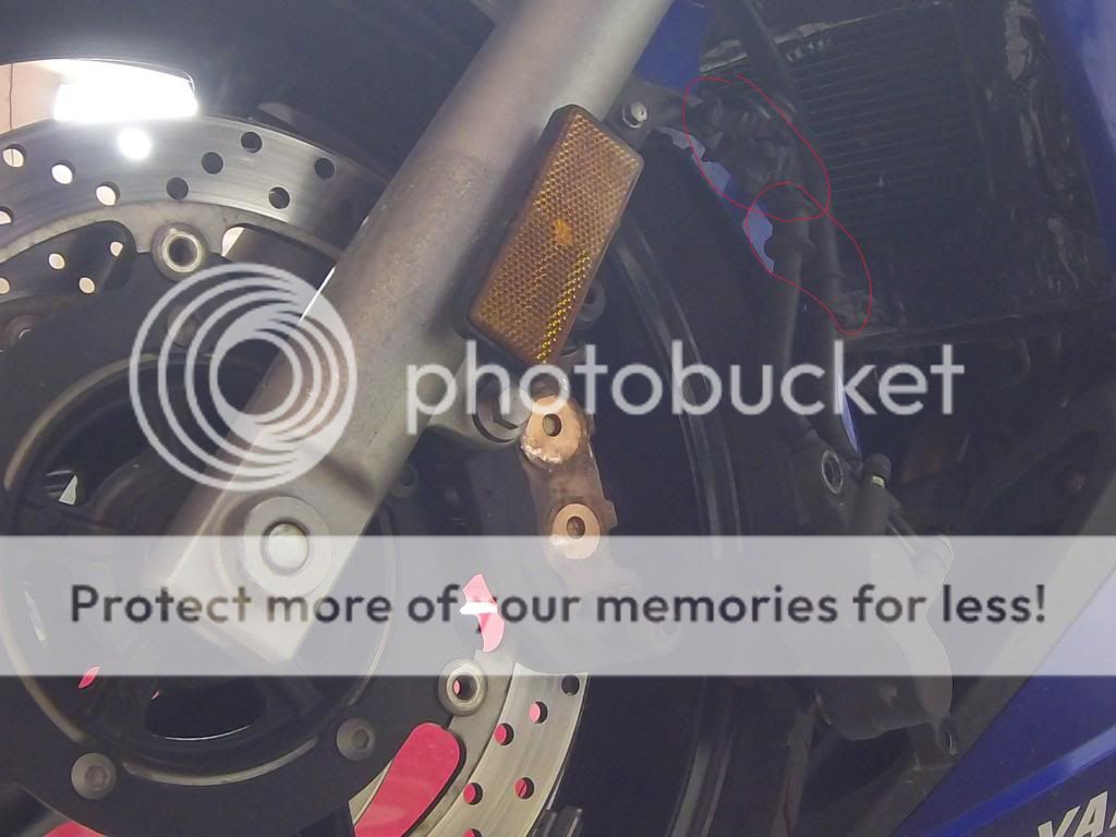

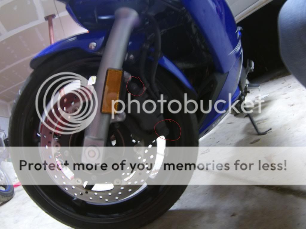

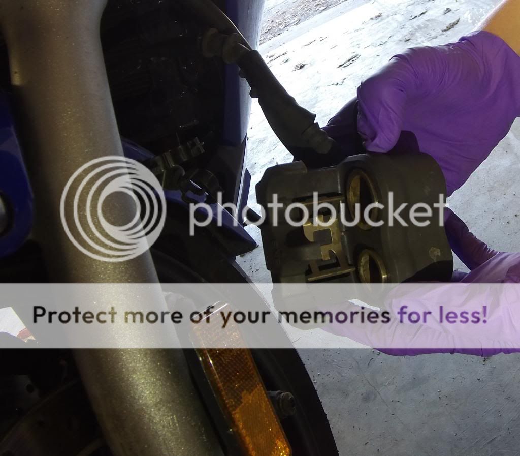

Open the loops holding the brake lines. Once open, pull caliper straight towards the wheel. Do not turn the caliper or it will be difficult to take off
The next pic, i am circling the loops. Forgot to take picture of it before taking off caliper.
Step 4:
Remove old brake pads by pulling the pads towards the side.

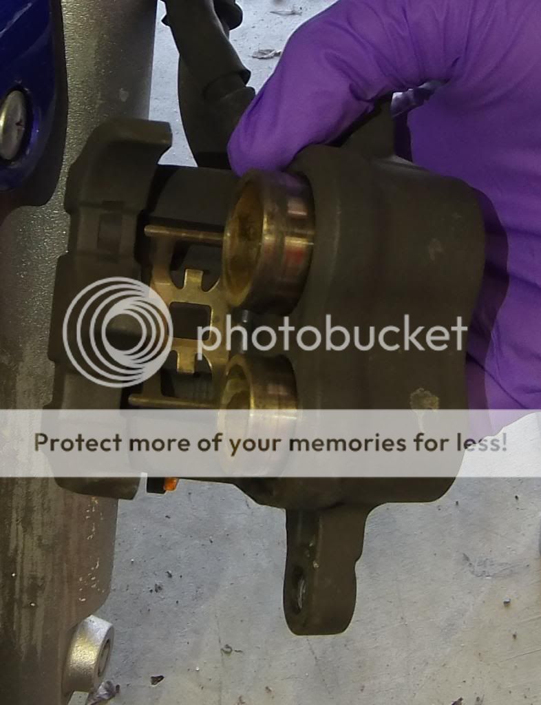

Step 5:
Spray pistons with the brake cleaner. Do not hold back. Use toothbrush to take off anything the cleaner does not get. Rinse off the grime with the cleaner. Repeat process until the pistons are clean. Make sure to use it in a well ventilated area and not spray any rubber material.
Step 6:
Push both pistons in at one time. If need be, use a C-Clamp to help push them down using a small flat board of wood. I used my ratchet handle to push them down at once.
Step 7:

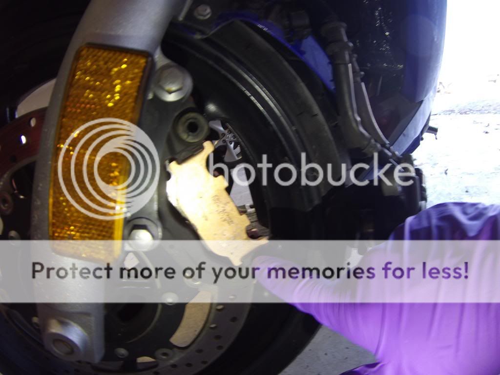

Inspect disc for excessive wear. Place new pads on their mounts. The pads direction do not matter. They fit in either position.

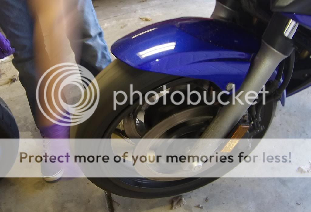

Step 10:

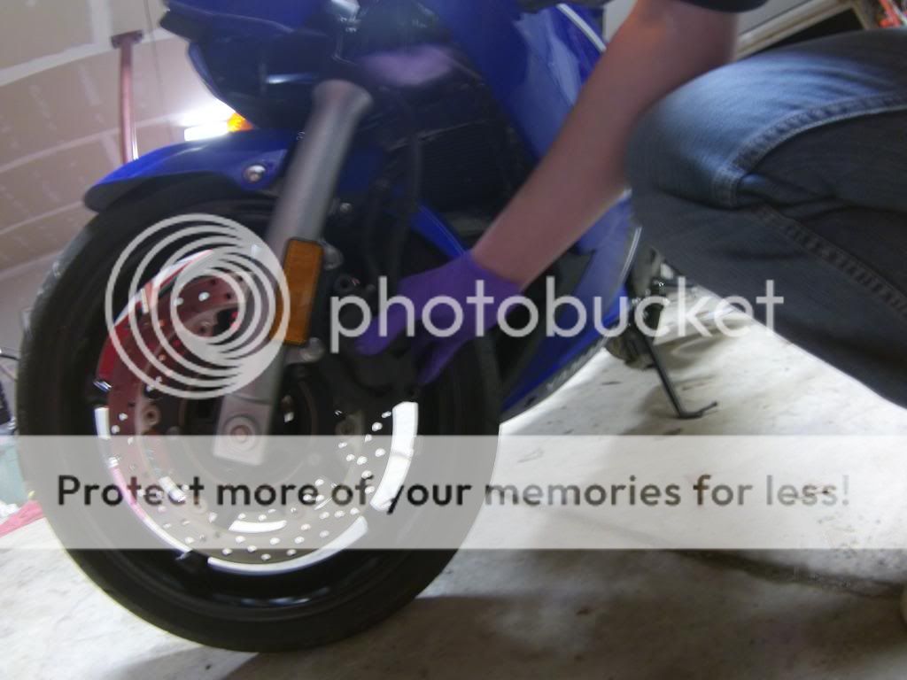

Once you have done both calipers, press the brake lever until there is resistant. Have the tire off the ground to allow free spin. With your right hand, spin the tire and with your left, put the brake lever tight once the wheel has spun. Hold the lever tight and tighten the bolts to 19 LB-FT Holding the brake lever while tightening allows the caliper to be tighten in the position to brake, not be at rest. This will help with overall braking ability.
Step 11:
Once everything has been tightened down to proper specs, spin the wheel. Make sure there is no major drag.
Step 12:
