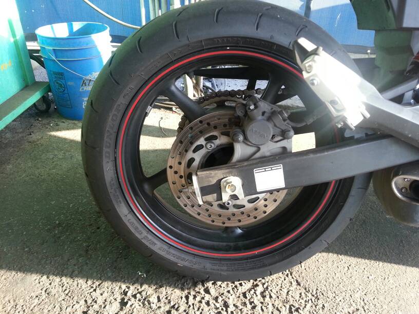

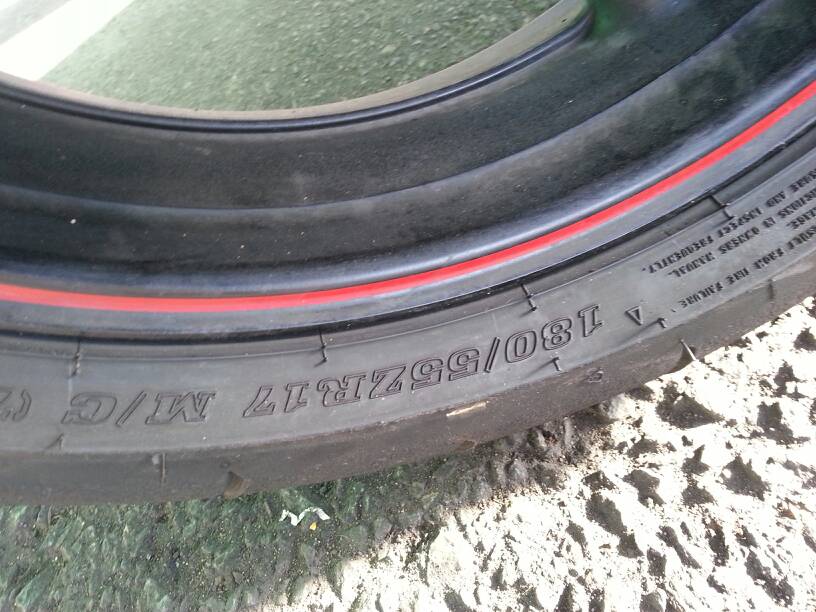

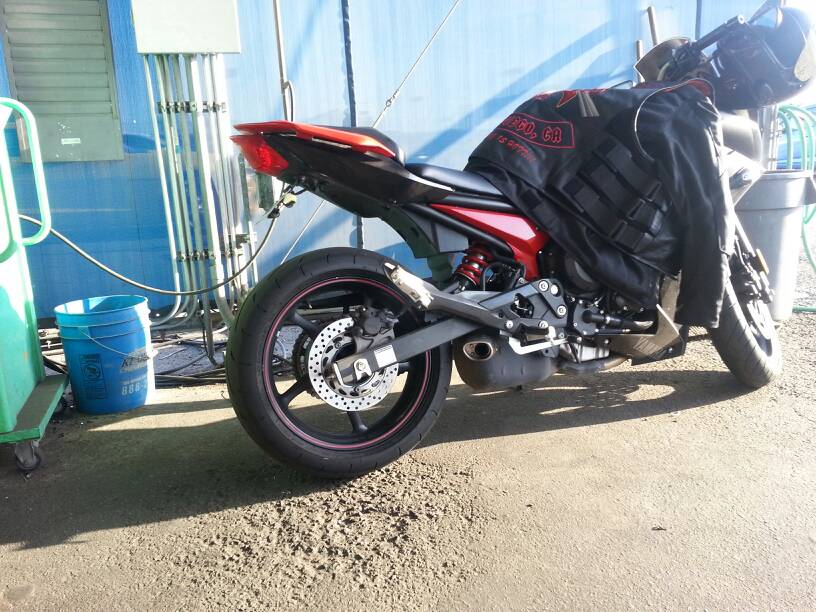

I have a 180 on my bike and love it I have a 2012 fzr the tire is a
Dunlop sport max q2 180/55/zr17
chago27
hello guys I have 2014 fz6r and upgraded the rear tire to 180/55/17 michelin 2ct i'm glad i did... overall more grip, better handling at corners and of curse looks better!! ;)
