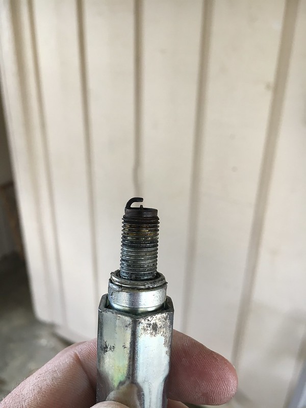

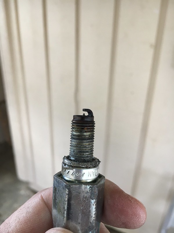

I included a pic below of a close up on my plugs (they all look like that) but let me give you a quick back story about my bike. I bought it in 2016 and it was bone stock with 7K miles. The guy who I bought it from was the original owner and the bike is pristine. At around 7500 miles I put on marthy's slip on Delkevic exhaust and install block off plates. I also replaced the stock air filter with another stock Yamaha air filter so no air box mod done yet. That's about all she had done since I did the plugs yesterday and PCFC.
To my knowledge the plugs I pulled yesterday are original. They all the look the same too. My bike has never smoked before yesterday so after installing the map, it smoked a lot. Definitely gray smoke but I didn't ride it like that but rather it just idled like that. I revved it a couple times to see if it would clear out but it didn't and then it actually died when the RPMs went down to idle. At that point, I installed another map (the stock exhaust/stock air filter from pc.com) and it stopped smoking almost immediately. At that point I took it for a ride and it seemed to run very well. I'm not sure if the map I got from Marthy was the correct one for me because I only have the PC Fuel Controller and not the PCV. He sent me another map that I'll try later today and see if that one is good. It very well could be that his maps aren't compatible with my controller but the PC tech said any map made on a PCV should work on my PCFC.
Martin has been helpful certainly and I appreciate his input to this site as well. Worse case scenario for me is after I do the timing advanced mod, I'll take my bike in for a dyno tune if I can't find a suitable map. I know the one I am using now is good but it could be better I think. I wish I got a PCV and could just run the adv gear map, but I didn't and my wife and I have an understanding that my money needs to go to other things than just myself lol.
Thanks for your suggestions and I've been learning from you and hope to learn more. Quick edit: took a short video this morning with Marthy's FZ6R Sport Map - looks good: https://www.youtube.com/watch?v=XIX3MeKvVO0&feature=youtu.be

All four plugs look like these two so I only pictured two. The one with the whiter center was the 3rd plug in line (looking at them in the head from left to right). The 3rd one and the 4th one looked like that and then the first two plugs on the left side of the bike were more tan in color.
I ran the slip on for about 600 - 700 miles up to yesterday before installing the PCFC yesterday evening. I still have the stock header on and replaced the crush gaskets with new oem ones back when I reinstalled it after putting on the delkevic can. Thanks for the pm too Rob, gave me some peace of mind with those plugs!

Reading those plugs is interesting. They are fine I'm sure so don't let my comments give you concern.
1. What is all the gunk in the threads, particularly around the crush washer in the first plug you are holding? Is your bike stored outside? Per our earlier discussion, maybe the prior owner used way to much anti seize? Look at the difference between my pic and yours. Yours only have twice as much miles on them. Mine was all with the stock exhaust and no Power Commander. Yours are some miles with the Delkevic on stock map I assume, as you just got the controller?
2. The first plug looks good, as does the second, but the second one is a bit richer. From your side pics in your other post, the electrode looks worn down to a thinner point (?)... not sure if that is an optical illusion. About the only thing that does that is detonation, or pinging or knocking as its called also. That happens from timing being too advanced or poor/low octane gas. Looking at your old plugs and new plugs in person, do the electrode tip, right where the gap is look worn and pointy, compared to the flat surface of the new plug at the gap? Are these both NGK CR9E? Do you run Regular or Premium gas, any fuel additives? I find it hard to believe there is anything wrong with the stock timing on the bike, but crappy fuel can definitely do that too. When you start the bike from a stop and and accidentally "lug" it a little, almost like it's it's about to stall, do you ever hear a ping or knock?
3. Just go out and enjoy your bike. Ride the snot out of it with the map you like best. Remember to check you oil and most importantly tire pressure before every ride. Maybe in another 1,000 miles pull the plugs to see if they look any different than new, or your old plugs.
Doubt you have anything to worry about.
I suspect when I pull my plugs with all my recent mods, that they will look a tad more rich than the last plugs I remove from it when it was stock. What will be interesting if my plugs will show any affect of changing my timing to approx 10 degrees. I have not heard any ping from it... so my assumption is I filed it about right, that is, not too much.

1. Yes I noticed the anti seize on there but didn't really think about it at the time. I'm think the original owner must've done plugs and used too much like you said. It's just like old anti seize in texture and appearance. I do store my bike in a carport outside and only installed the PCFC as of Thursday so it's new to me. The exhaust and other mods are from 2016.
2. The old plugs are NGK Iridium CR9EIX. I never knew that about spark plugs and just checked the tips. All of them are flat and the same. I think it just looks pointy in the pic. That's good news to me now that I know that. I didn't have any pinging before, or at least not that I ever noticed. The two plugs on the right were loose where I didn't have to break the seat when I was uninstalling them like I did with the 1st two. I only use Shell gas and generally unleaded but I did add some lucas fuel stabilizer over the winter a couple times. When I've nearly stalled or did stall out before I didn't hear anything unusual. Do you think I should start running premium fuel?
3. I'll definitely pull the plugs in a 1k miles and post back some pics. I'm very interested to see what shows up myself now. I wish I knew what you do, but I know I'll get there eventually. I'm going to ride today and will run it a little on the harder side and see what happens. I did notice that my engine temp was lower than usual. Usually it's up to 180 when I run it for 20 minutes in 50 degrees but it stayed around 167 most of the time yesterday.

Ok, based on your plug description it must have been the pic angle that made the tips look pointy. I think everything is A-ok with your engine. Premium vs Regular is as controversial as which oil to run. I figure, relatively speaking, I use so little gas in my bike compared to my cars I'll run premium all the time. When you change the timing you will ALWAYS need to run Premium.
